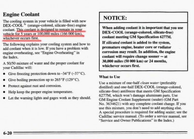

Другое интересно. Читаю кадиллакфорум, так там у всех мания, что нордстар страшно перегревается, если не менять раз в четыре года охлаждающую жидкость. Везде первый совет - меняй жидкость только купил... :stars: Нифига не понимаю. :wall:
Возможно, они не знают его реальный температурный режим, видят цифры - и пугаются... :crazy:

Hey guys, I found a 96 Deville for sale locally, with ONLY 34,000 miles on it!!!!
It is as clean as could be. It is white, with cream/tanish interior in perfect condition.
The asking price is $4999, which I think is pretty reasonable. Car is basically new!
But I had a 98 Deville, with the same engine, and I have had more problems with that car! Head gaskets! And aftermarket radio problems!!!
Is there anything I should worry about with the 96 model year?
Do these cars have the same radio problems the 97-99 devilles had?
Any future engine probs to worry about?
Headgaskets, RSS if it's a Concours, and pretty much anything else that could possibly break -- could all be a problem.
Yes, you will have the same aftermarket radio problems as w/the '98.
This isn't to say I wouldn't jump on it -- if you don't have problems it will be a great car for very little money. 2.5 yrs ago, I bought my '95 Concours w/48K miles on it, and now it has 70K. It was in excellent condition when I bought it.
I've replaced the digital dash, the A/C compressor, power window motor, the drivers lock is messed up and will trigger the alarm if you use the key to open it (didn't fix), it needs a fuel pump, and that's just what I remember -- I'm sure there's more. I paid $7K for the car and have probably put $3K in it.
Mine gets mostly highway miles, so I'm not sure if you used yours as a daily driver stop and go city car, it might be harder on it.
Get the coolant gas check, see how much oil it leaks from the rear main seal, have it checked out w/a mechanic otherwise, and if it checks out get it and have the coolant changed first thing.
И так практически везде.... :wall:

Да всё может быть. Только дето ж они берут это, что головки блоков у них расходник... Причём пробеги - 40-70 тыщ миль... ;)

5 лет - в мануле написано
У меня печка потела возможно из-за несвоевременности, хоть и 98 000 км было :pardon:
Залил в кадди http://www.peakantifreeze.com/peak_glob ... _5050.html
В вольво - в синей канистре (зеленоватый).
Если надо - найду фирмочку. Недорого стоит.
А про головки - гонят. В Нордстар что-то около 100 000 миль только свечи менять надо. ОН, по идее, неубиваемый. А америкосы известно как за машинами смотрят, особенно секонд-хенд... :wall: Ездят пока не станет авто совсем, а потом хелп :stars:

Я почитываю этот форум, на нем есть много интересной информации.
Возможно, это связано с тем, что рабочая температура двигателя находится у верхней границы. В таком случае перегрев чреват серьезными проблемами для головки. И еще где-то читал, что для ДВС с алюминиевыми блоками и головками обязательна смена охлаждающей жидкости во избежании коррозии, которая возникает когда антикоррозионные свойства ОЖ значительно уменьшаются.
Итог - нам надо очень внимательно относиться к температуре. Я всегда держу включенной именно этот показатель на приборке.
Ага, пять лет. Они могли это и не учесть, когда его писали...
